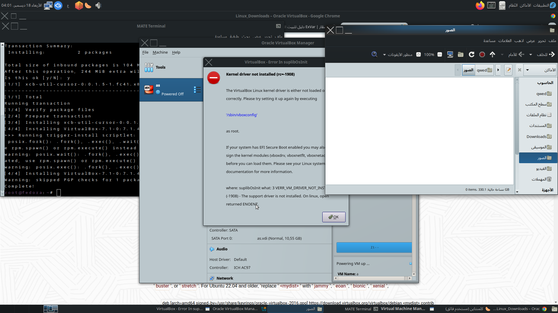

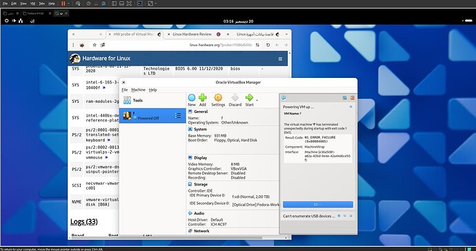

مشلكله في برنامج Virtual Box
مثبت فدورا على برنامج فموريك
احمل نسخه متشتغل النسخه
جرب الأمرين التاليين:
sudo dnf install make time perl gcc dkms kernel-devel kernel-headers
/sbin/vboxconfig
وبعدها أطفئ الجهاز وأعد تشغيله
على توزيعه يبنتو او توزيعه اخرى
على توزاعات اخر مثل اريش او اي توزيعه اخر
واشكران

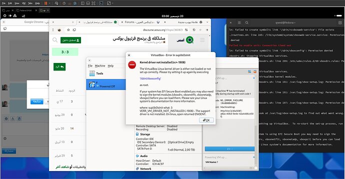

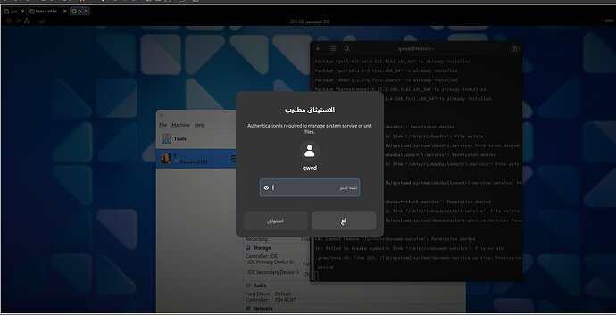

المر مهوى شغل اجتلي هدي الرسله
هدى التقرارير حق المر
[qwed@fedora ~]$ sudo dnf install make time perl gcc dkms kernel-devel kernel-headers
/sbin/vboxconfig
[sudo] password for qwed:
Sorry, try again.
Updating and loading repositories:
Repositories loaded.
Package “make-1:4.4.1-8.fc41.x86_64” is already installed.
Package “time-1.9-24.fc41.x86_64” is already installed.
Package “perl-4:5.40.0-512.fc41.x86_64” is already installed.
Package “gcc-14.2.1-3.fc41.x86_64” is already installed.
Package “dkms-3.1.3-1.fc41.noarch” is already installed.
Package “kernel-devel-6.12.5-200.fc41.x86_64” is already installed.
Package “kernel-headers-6.12.4-200.fc41.x86_64” is already installed.
Nothing to do.
rm: cannot remove ‘/sbin/rcvboxdrv’: Permission denied
ln: failed to create symbolic link ‘/sbin/rcvboxdrv’: File exists
./routines.sh: line 165: /lib/systemd/system/vboxdrv.service: Permission denied
rm: cannot remove ‘/sbin/rcvboxballoonctrl-service’: Permission denied
ln: failed to create symbolic link ‘/sbin/rcvboxballoonctrl-service’: File exists
./routines.sh: line 165: /lib/systemd/system/vboxballoonctrl-service.service: Permission denied
rm: cannot remove ‘/sbin/rcvboxautostart-service’: Permission denied
ln: failed to create symbolic link ‘/sbin/rcvboxautostart-service’: File exists
./routines.sh: line 165: /lib/systemd/system/vboxautostart-service.service: Permission denied
rm: cannot remove ‘/sbin/rcvboxweb-service’: Permission denied
ln: failed to create symbolic link ‘/sbin/rcvboxweb-service’: File exists
./routines.sh: line 165: /lib/systemd/system/vboxweb-service.service: Permission denied
Failed to enable unit: Connection timed out
wln: failed to create symbolic link ‘/sbin/vboxconfig’: Permission denied
vboxdrv.sh: Stopping VirtualBox services.
/usr/lib/virtualbox/vboxdrv.sh: line 299: /etc/udev/rules.d/60-vboxdrv.rules: Permission denied
vboxdrv.sh: Starting VirtualBox services.
vboxdrv.sh: Building VirtualBox kernel modules.
/usr/lib/virtualbox/vboxdrv.sh: line 191: /var/log/vbox-setup.log: Permission denied
/usr/lib/virtualbox/vboxdrv.sh: line 197: /var/log/vbox-setup.log: Permission denied
vboxdrv.sh: failed: Look at /var/log/vbox-setup.log to find out what went wrong.
There were problems setting up VirtualBox. To re-start the set-up process, run
/sbin/vboxconfig
as root. If your system is using EFI Secure Boot you may need to sign the
kernel modules (vboxdrv, vboxnetflt, vboxnetadp, vboxpci) before you can load
them. Please see your Linux system’s documentation for more information.
ليه يومين محد يرد
هدى المشكله

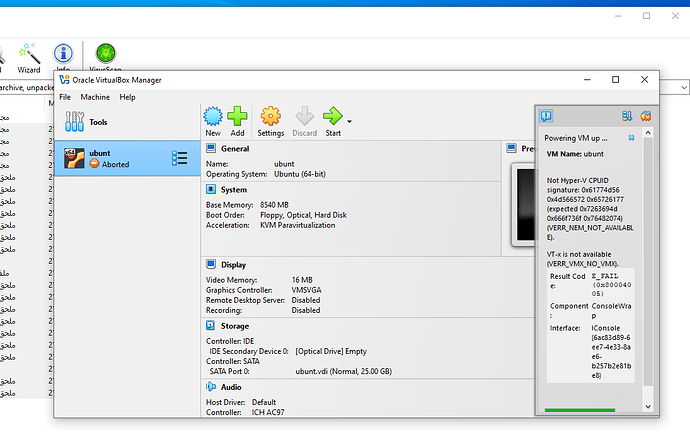

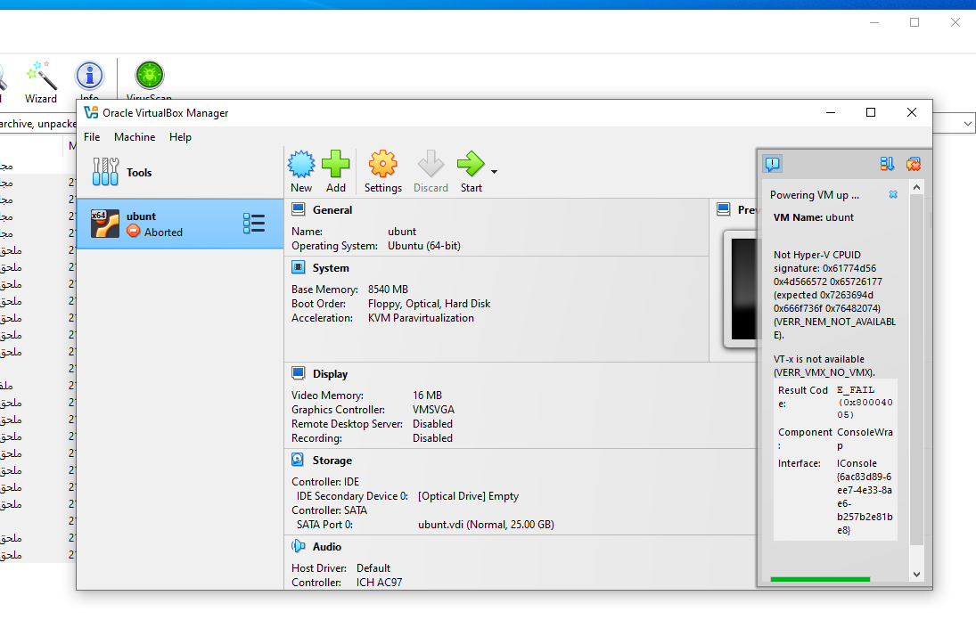

المشكله في الوندوز

بدايةً الفيرتشوال بوكس يعتمد على مودل مهم لتشغيله و هو vboxdrv و الشي الآخر تفعيله من البايوس.
للتأكد من أن الحاسوب يمكن تشغيل الفيرتشوال بوكس أو أي أداة محاكة إفترضية ضع الأمر التالي:
egrep -c '(vmx|smx)' /proc/cpuinfo
هذا الأمر سيعمل سواء على الماك و البي اس دي أو على لينكس بكل توزيعاته
اذا كانت المخرجات صفر كالتالي
0
فإن جهازك معطل به خاصية virtualization من البايوس، أما إذا كانت المخرجات أكثر من صفر مثلاً 16 فهذا يعني أن الخاصية مفعلة في البايوس، ولتفعيل خاصية virtualization في جهازك فإن تلك الطريقة تختلف من جهاز لأخر و لكن يمكنك مشاهدة الشرح التوضيحي هنا.
بعد التفعيل الخاصية عليك اعادة ترجمة المودل الخاص بـ virtualization عن طريق الأمر :
sudo /sbin/vboxconfig
ثم أعد تشغيل الجهاز و سيعمل لديك الفيرتشوال بوكس بعد التشغيل.
